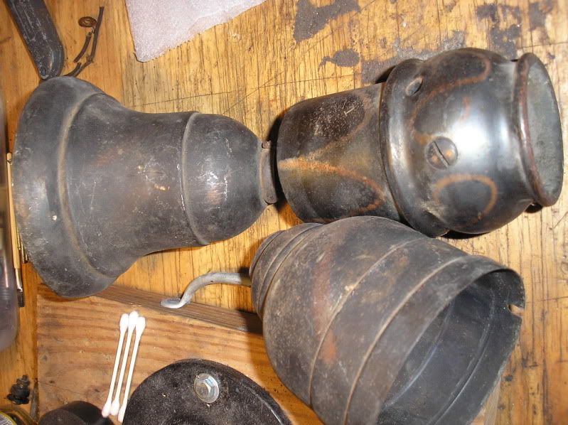

Oil cup had no drain screw (and no oil), but had a level screw or maybe a fill screw about an inch up from the bottom.
Attached Image (viewed 2445 times):

12) Remove the adjuster ring. It is made of a copper plated steel, blackened.
Attached Image (viewed 2356 times):

I think I understand the finish, but tell me if I'm wrong. The finish on all the steel and cast iron parts is copper oxide. It seems that copper normally turns green when it oxidizes, just like iron turns red (rust, FeO). Modern black oxide like you would see on a black bolt is a finish where hot chemical baths form a black oxide (Fe2O4) that protects the metal and keeps the red rust from forming. Copper also has several oxides. Instead of the green oxide, you can make copper form a protective black surface oxide (CuO) with a chemical bath.  It looks like a thin black paint applied over copper. When the part is new, it looks like a nice black paint. After a while it will get surface rust, like when a gun rusts if you don't oil it.
Back To Top PMQuoteReply
 Posted: Mon Dec 16th, 2013 05:09 am
  PMQuoteReply
86th Post
David Hoatson
Joined: Sat Oct 5th, 2013
Location: Chestertown, Maryland USA
Status:
Offline
Below the black finish, there is copper in some areas: the lower section of the main frame, the oil cup, and the adjustment ring. The upper part of the frame and the entire lower cover don't have copper under the black.
How did they do this in the old days?  Electroplated copper onto the iron, then a chemical dip to turn it black?
Interesting stuff.

David Hoatson
Status:
Offline
The parts are cleaned up.
Attached Image (viewed 1588 times):
 Posted: Sat Dec 21st, 2013 09:40 pm
  PMQuoteReply
106th Post
David Hoatson
Status:
Offline
I'm going to try to get a copper oxide finish like original.
Attached Image (viewed 1606 times):

I got two types of Liver of Sulphur today: rock and gel. The rock form seems a little faster/stronger. I cleaned pieces of copper pipe with steel wool or sandpaper. It acts fast and leaves a gray color. I buffed a piece after it dried with a electric buffing wheel, making a cool shiny gun metal look with a little copper color. Picture of one un-buffed and one buffed piece:

I've got the castings cleaned up, using a rotary file, and grades of sandpaper from 60 to 220. Off to the plater tomorrow to get copper. I sanded the badge with 600 grit to highlight the raised lettering.  Under the black was a thin layer of copper, then the brass base material. It was originally all black copper oxide coated.
Attached Image (viewed 1774 times):

 Posted: Wed Jan 22nd, 2014 03:13 am
  PMQuoteReply
150th Post
David Hoatson
Status:
Offline
Should I make it black? All polished copper? Copper only in the vents? Stencil a pattern with clear lacquer so copper and black?
Attached Image (viewed 1572 times):

Think about your overall fan presentation (blade irons, cup, lights, etc).
I am partial to spirals going in the blade direction myself.

Thanks, Tom. I'll figure it out. If I don't like it, I can buff it to copper and try something else. I almost wrapped lace ribbon around the outside and clear lacquered to make a copper lace pattern. As boring as it sounds, I may just do it all oxide, with the only copper on the lights. Any ideas for designes? Maybe a couple copper pinstripes? Silhouettes of Stsr Was characters? As my son says: "you won't see the design once it's covered in dust"

I'll find out tomorrow. I'll have two solder connections of 5 wires each for the lights. I'll try to do the solder outside the oil cup, then coil up the slack in the oil cup above the switch. There is a space 1" high x 2" diameter above the switch.

I think it just depends on where the lights are drilled out. Some are drilled higher, some are drilled lower. Mine has none. And I'm just doing an on-off switch rather than a 3 speed (toasted speed coil).
