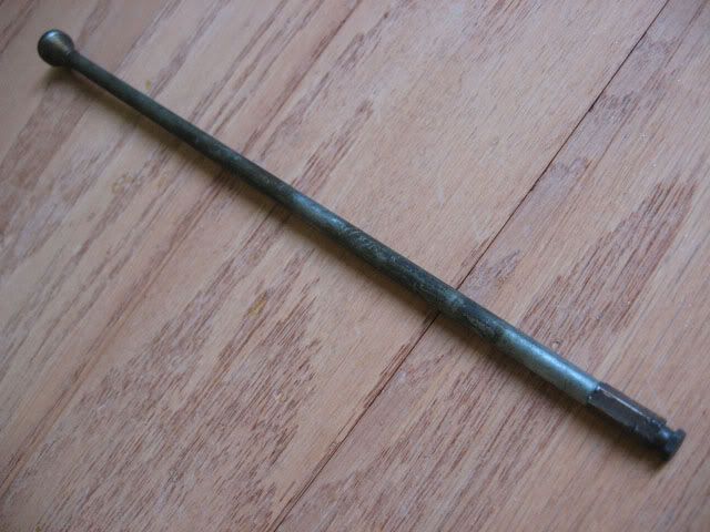

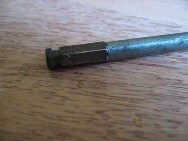

I've attached pictures of an Open Top Century Model 15 switch rod.  The copper hex end appears to be pressed on and does not unthread.  Nice find Peter!
Back To Top PMQuoteReply

Nick Rodnicki Jr wrote: I've attached pictures of an Open Top Century Model 15 switch rod.  The copper hex end appears to be pressed on and does not unthread.  Nice find Peter!
Ok, I'm quoting myself here and correcting myself.  After closer inspection the switch rod obviously started out as steel hex rod stock and was turned down to be round. The part that is copper is either copper plated or flashed copper.
Peter, just twist the switch rod counter clockwise and it will unthread itself from the switch.  If you take the top off the fan you can see where the switch rod attaches to the switch.
Looks like Chuck has you covered on the switch knob & bracket.
Just an FYI these are some of the heaviest ceiling fans out there and extremely well built.
Good luck.

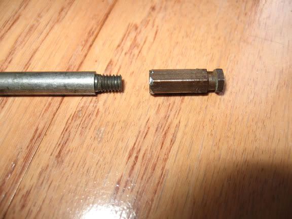

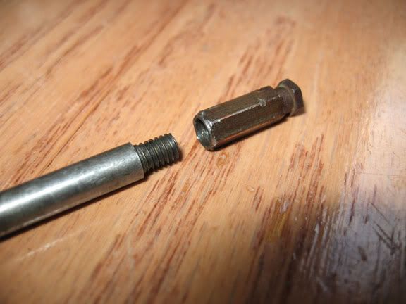

You do not have to open the fan to get the switch rod out, simply grab the hex end and turn counter-clockwise. It will unscrew from the switch stem.

ok so I got the rod out and Chuck it is a hex screw on so that means I'm in the safe zone, Whew that was close!!!

Great, Peter...now what is the thread? Find a 10-32 and a 8-32 and 6-32 nut and try to see which one fits. Snap switches used a variety of threads, which is where I would get a knob for you.

You were right.  That switch rod had me fooled because virtually no parting line was visible between the hex end and the switch rod.  With a little coaxing in the shop the hex end unscrewed from the switch rod to reveal  8-32 threads.
Peter, did you measure 8-32 threads also?

Chuck Abernathy wrote: Great, Peter...now what is the thread? Find a 10-32 and a 8-32 and 6-32 nut and try to see which one fits. Snap switches used a variety of threads, which is where I would get a knob for you.
Nick and Chuck I will go to home depot first thing in the morning and get the thread size and see what it is. I am so glad and happy with the response and support I am getting in making this Century fan work.

Hey Nicjk and Chuck mine measured 8-32  I went today to the homedepot and got it.
